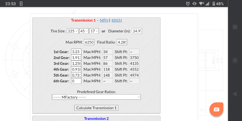

I typed mine in a calculator, and get this (pretty similar as I previously have gotten in calculators which is part of my cause for concern) :
You do not have the required permissions to view the files attached to this post.
Topic author - Posts: 19
- Joined: 29/07/21 21:15
- Been thanked: 1 time
Re: 2gr standard ecu speed limit?
I'll add, for the above screen shot, those numbers do seem to be correct (absolutely close enough) with respect to top speeds in gears 1-4, but 5 throws it all up in the air and doesn't match the speed I'm at when I limit out.
